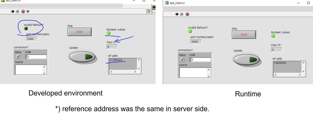

I am working with Open Application Reference between a server and a client.
I have to check the status of server side using the disable property or other property of button.
To do this, I used a reference indicator and GET method to get the reference in client.
In development environment of LabVIEW 2018, everything is okay.
In runtime engine (.exe application), the reference seemed to be okay because of the same ref. address apparently.
However, the property node (here, ClassID) of the reference is not working (error 1055, invalid reference).
I suspect surely the shift register of while loop in client but, I need to use the shift register because final goal is to load by functional global variable.
In other trial, this behavior was the same with functional global variable containing Open(open application reference) and Get(get property node).
I enclosed the example code for you and let me know how can I get a valid object reference.
Server: flipping the button
Client: push the update.
Builds: the zipped file includes .exe file. If removed, please compile server and client again.

Roughly thinking, it is right that Invoke Method:Control Value:Get I used cannot handled with memory (reference) in runtime applications.
When running in the IDE they share the same application context. When you build them into separate executables they do not.
References are only valid in the application context they were created in. You can't pass references between two different applications by their underlying numeric value like that.
See attached for a working implementation where the client obtains its own reference to the control.
