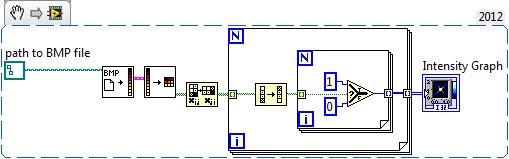

It depends on the image and the LabVIEW module that you have installed. Labview can open bitmap and png files and convert them into arrays: if it is really a monochromatic (1bit depth) you get a 2-D array of boolean, T for white, F for black. You only have to look at the element index to know its coordinates (remember that LabVIEW doesn't use the common order of rows and columns, so you have to transpose and reflect the array). If you have a 24bit bitmap, the array will contain the colours in hexadecimal rappresentation (000000 for black, FFFFFF for white and so on); again, you only need to check if the element of the array match your conditions and get its indexes.
With the vision module you con open other images and perform advanced operation on them without converting them into arrays. Anyway, you can just type your image extension into the LabVIEW help and look at what you get.
Here a snippet to open a monchromatic bitmap

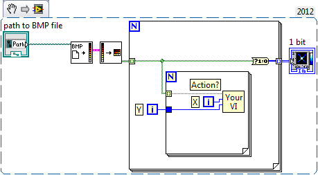

Here's a slightly simpler version.
(Depending how you want to process the output, you might not need to traspose and/or reverse. Boolean to 0,1 works directly on the 2D array if needed ;))

OK, since you can write these points in any order, you don't need to transpose or reverse. Easiest would be to reshape to a 1D array and process them in memory order directly using an autoindexing FOR loop.

I'd rather use two nested for loop: this way you can use the two indexes to control the step motors; what are the advantages of using a single one?
