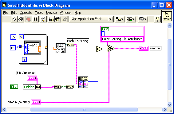

The Write to Spreadsheet File has an output called new path. This is the path to the file you specify. Use a Path to String function on File I/O>Advanced File Functions palette and wire this to the file name input of the Call Library Node.

Hi Fonsi,
It looks like Dennis beat me to the answer. Take a look at the block diagram below for an idea how to set your new file to be "hidden". I would also like to point out that "hidden" files on Windows may not really be hidden from the user. In the folder options any user can optionally show hidden files, and hidden files can still be read an modified by users on the computer.
Scott Y
