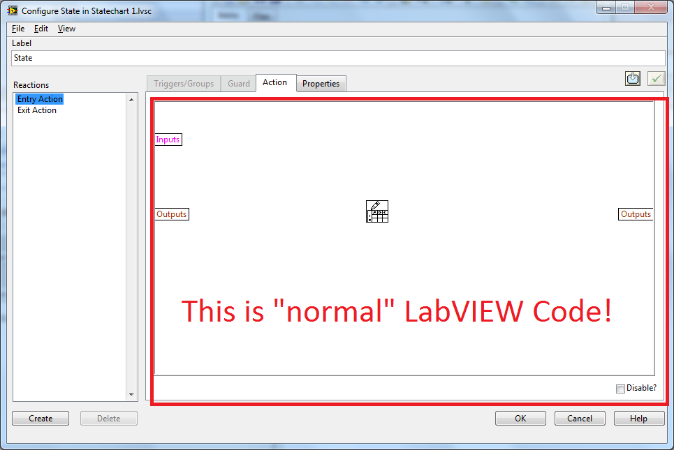

I would like to use two different subVIs in the same machine. One of the subVIs will write data (only numbers) on a worksheet ant the other will read the written data(numbers again).
(2,758 Views)
Accepted by topic author OzBdx
Sure this is possible.
hope this helps,
Norbert
