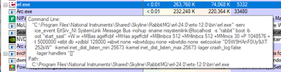

looks like RMQ is in NI's installation of something...
and some app to reconfigure it as a client...
So in this case it could be that the RMQ I installed simply updated the one I didnt know was there...  but I don't understand how the path variables etc are overwritten each time I uninstall and reinstall...  I guess it runs the reconfig everytime it has an issue with the rmq server...  I renamed the folder with all this stuff in it and now there's only a few items - the exchanges and the listener ports in the RMQ server that are still reconfigured somehow, must be different process doing it?
NI Skyline software changes the port of the RMQ listeners to default+1.  I need to change that back - it's normally done with a config file, but I can't figure out where that's located with a normal installation.
RMQ's documentation is pretty awesome, but the path var they call out is one being changed by NI's software i think so I'm not sure how to... not let that happen
I think my number one complaint here is that there is no uninstaller for systemlink/skyline, or at least not one I can find.
