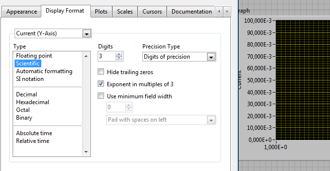

         I am new to labview. I am setting up a measurement where i need to source a voltage from the keithley 2636 and plot the current and resistance. I hae used the labview drivers of keithley 2636. The problem I am facing is this. Suppose I get a current value of 1.23e-3 for a particular voltage, the graph takes 1.2e-3. It does not take the remaining digits. I have attched the IV curve im getting thus. The probes were connected to a 2.2k ohm resistor to check my program. Also when i include negative voltages in my sweep say like if im sweeping from -2 to 2 then the current values in between go to e-8 range which cannot happen as my resitor value iss 2.2k and any vakue of voltage in between -2 to 2 will not result in a current less than e-4. I have attached the labview vi and a screen shot of the iv and resitance versus voltage measurement. Please help as im stuck at the oint for many days.

The graph only show the values like the ouput from the string delivers, you can modify the shown digits
Hope it helps

Thanks!
