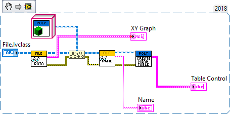

If I want that Poly.lvclass does something specific with its data, I have to create a method for Poly.lvclass. In the block diagram, if I wire the parent class to that VI, then it will break. I solved this by addind a 'To More Specific Class' element before the new method. Is this the correct way to do it? Or am I missing some fundamental idea about classes?
(2,814 Views)
The reason it breaks in your code is that there is a difference between the actual information carried on the wire and the color of the wire. In your code, the "File.lvclass" terminal you have means that, from the point of view of this subVI, you have a "File" object. When you try to call a Poly class method on the File wire, it throws an error, because this VI is only able to see the parent- since that's the control you used to make this VI.
"To More Specific Class" tells the computer that hey, I *know* this is actually a Poly class, so start treating it that way. You're giving it more information so it can determine what to do.
Basically, creating this subVI with File (parent) controls indicates that this subVI can accept *any* class of File or its children. As the Poly method only works on Poly children, the wire breaks. If you use this subVI in code where you only wire in a File object, you will throw an error at To More Specific Class. That function simply tells LabVIEW what the wire *already is*- it does NOT *convert* the object *to* the more specific class, just the appearance.
To fix it, change the File.lvclass control to a Poly.lvclass control. FYI that, very generally, needing to use To More Specific Class often (but certainly not always!) means there's a better way to do whatever it is you're trying to do, namely, by using dynamic dispatch overrides. Again, not a hard and fast rule, just a rule of thumb.
