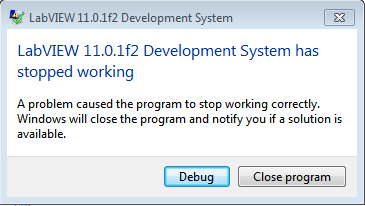

I was using LabVIEW 2011 SP1, but I just upgraded to the f2 patch (which did not help).  Here are the series of error messages I get:
Step 1 try to build the exe, it gets almost to the end and then freezes up:

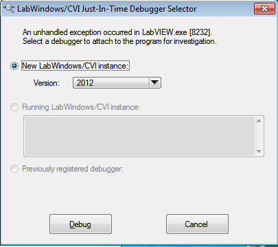

Clicking degug gives:
Debug...

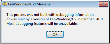

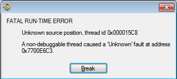

Ok...
