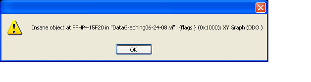

hi there,
i somewhat got it to work.
but i am having this error everytime i try to save it.
does anyone know how i can get rid of it?

You might want to look into What Does an "Insane Object" Error Mean and What Should I Do?
Hopefully this helps!!
