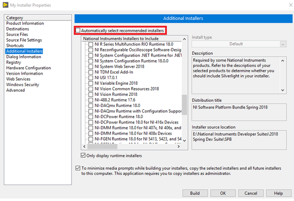

Hi alisa87,
When you create an installer, LabVIEW allows you to manually select the drivers you want to include in it. In the installer properties make sure you disable the "Automatically select recommended installers" option: INstallers.png
Then add the ones you want to include with your installer.
Hope this helps.

Thanks for your response.
I have tried as per your suggestion,but still same popup occurs.
What i have observed is if i deselect "NI Visa runtime 15.0.1" from the list it allows me to create installer.
But my problem is i am using VISA in my code so i have to include the same while creating installer.
Please suggest any other method or should i install NI DAQ drivers?

Hi Alisa,
NI DAQmx needs to be installed in your computer or externally available so that the Installer Builder has access to the NI System Components. Try installing DAQmx and leave the auto driver selection enabled.

Hi Alisa,
Actually, this is by design, and don't worry - you're not pulling in any additional drivers that you're not intending. It's because NI's software is modular, and underlying software components are shared across many products and drivers.  Please see the following KB for more information (in particular, the "Additional Information" section):
http://digital.ni.com/public.nsf/allkb/C3666BA408F81E59862570D20056E692?OpenDocument
- Wes

Thank you for reply.
which driver should i install in my PC NI DAQmx or NI DAQmx RUn Time Engine. I am confused .
Will you please provide the setup link to install the driver?
Message 9 of 16
(3,351 Views)
Just put a check mark back in the "Automatically select recommended installers" and let LabVIEW decide for you.
