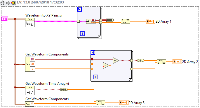

The problem you have is because you are using "Build Array" with an array of doubles, and a waveform.
An array can only contain one data type.
Consider converting the waveform to XY arrays using either "Waveform to XY Pairs" and a For loop to Unbundle them, "Get Waveform Components" with a For loop to reconstruct a Time array, or "Get Waveform Time Array" and "Get Waveform Components" with the Y component to get 2D array outputs.
That should be what you need for the CSV file you seem to be writing.

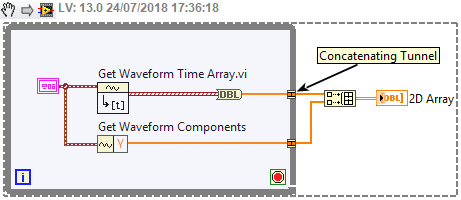

Edit: You have an array of waveforms from the Timed Loop. If each iteration gives only one point, it might be easier to convert to a DBL value or series of DBL values inside the loop, so that you have a suitable 2D array starting from the Timed Loop.
Nonfunctional example for inside the loop, using Concatenating tunnels:
