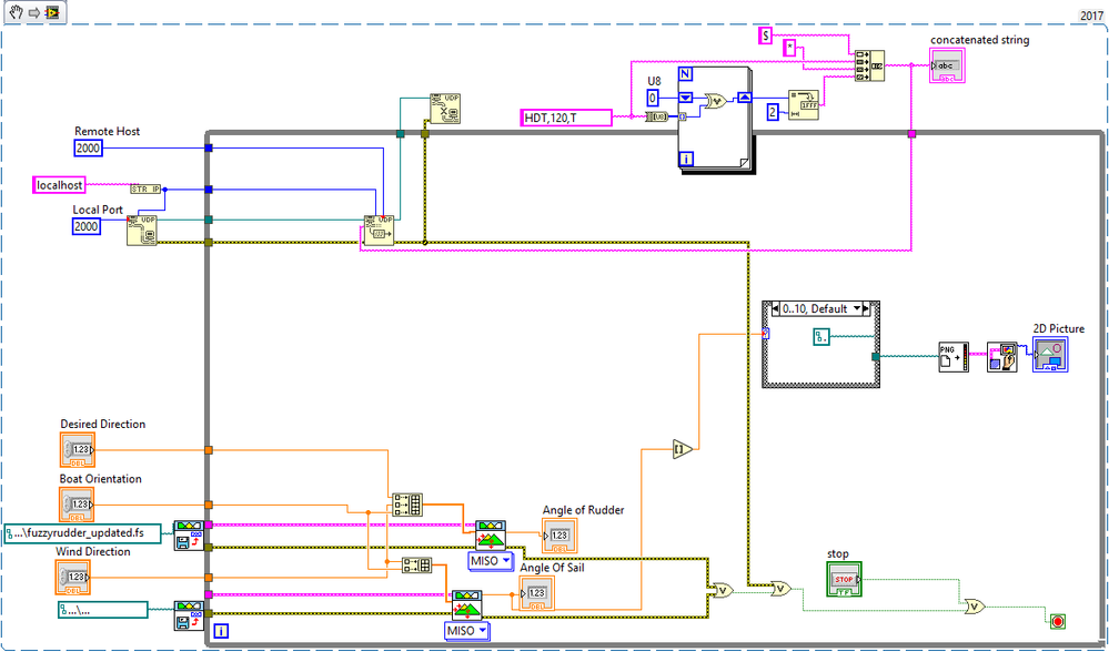

This is my program
in the top left hand corner of the while loop is my interpretation of  mimicking a web server with a port of 127.0.0.1:2000
and writing data too it continuously

its not working by the way was just hoping someone could point out my errors
(3,957 Views)
thanks for the help
turned out it was working all along
it was just a case of closing the application and reopening it
