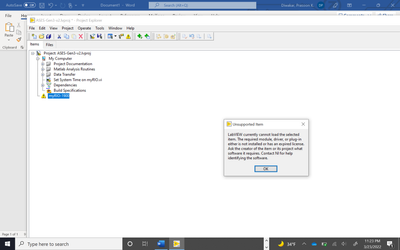

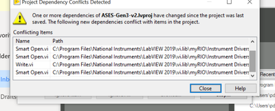

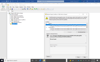

With Labview 2019 and Myrio, these are errors I get
When I click close
It appears its looking for myRIO file in vi.lib folder which doesn’t exist, I guess.
Although both myrio 2019 and 2017 are installed.

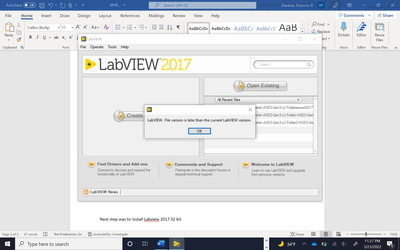

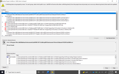

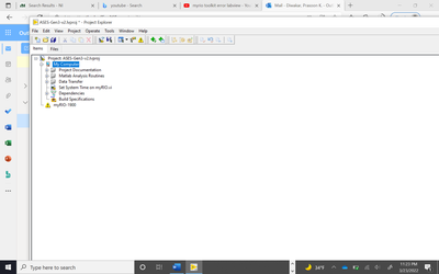

When we open the vi file using 2017 version,
It gives following error

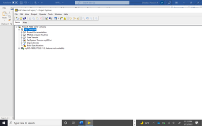

We also tried connecting the instrument and turning on RIO device set up. It did recognize the instrument and gave an option to launch using Labview 2017SP1, When we click on that, it gives same error as above.
Lastly we tried saving the file as prior version.
We used our Labview 2019 and opened the file and saved it as 2017 version
Now I used the 2017 version file and opened using labview 2017 again
