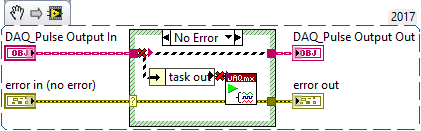

As for the wiring error, I suspect you may be right. The parent class private data control is used to pass the DAQmx task handle (as well as some other values).  Since the problem I am getting seems to be with the task not getting recognized, I suspect this is part of the problem. I believe this is the problem. (ignore the broken wired due to class not attached)

TeraTech wrote:
Perhaps I should pass the class reference all the way through and not re-bundle it?
Correct.  There is no point in getting a reference and writing it right back in the same place; the value of the reference is the same.

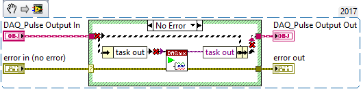

"...no point in getting a reference and writing it right back in the same place."
Except for the task is first created, right?
I removed all the "re-bundles" in all VIs in the parent and child implementations, except, as mentioned in the class that first created the task.  It did not fix my issue.

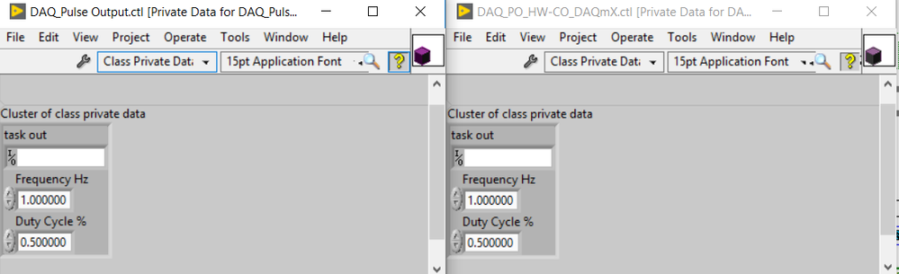

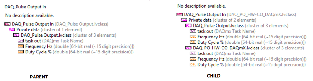

The the crux of the issue is when their is no child implementation of Stop (which does the Stop and Clear task) the parent implementation of the Stop VI does not stop and clear the task because I can see the output still running on my scope.
Here's one other curious thing - and likely the reason why things break when dynamically resorting back to a parent implementation at run time. The parent has a cluster of elements (including the DAQmx task) while the child class appears to have it duplicated inside its own private data.  This may have resulted because to create my parent class, I copied (and renamed) my original class (now a child) and changed the inheritance to point to the newly created parent.  Trouble is, I don't know how to fix it.
Message 5 of 13
(7,066 Views)
Yep, that is definitely your issue.  The immediate solution is simple: remove those parameters from your child class.  But then that will break a bunch of stuff.  So you will want to make "protected" VIs that the child classes can call to act on the parent's private data.  By using the protected access, only children of the class can call them.
GCentral
