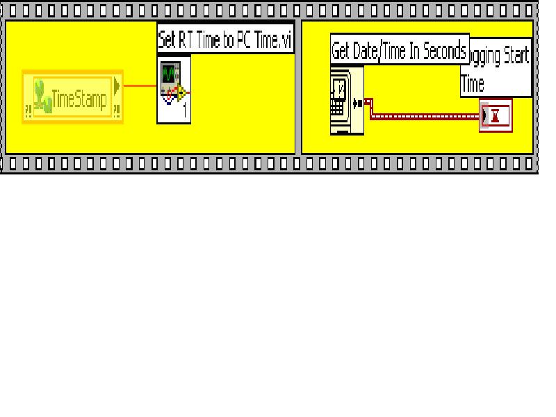

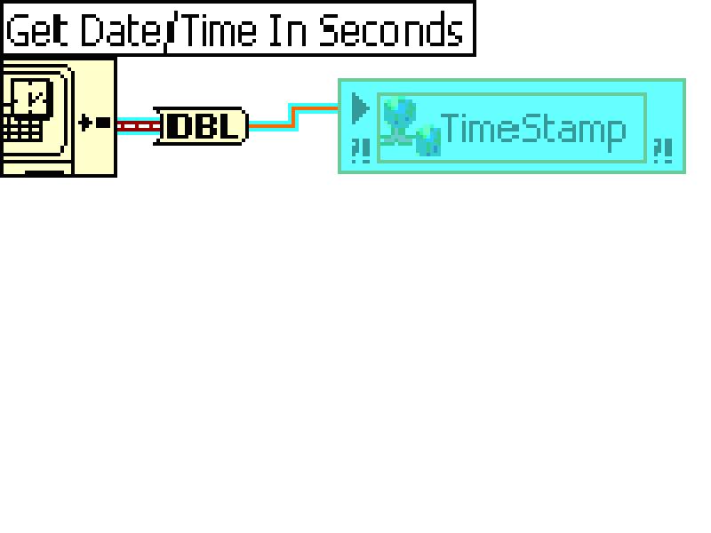

Here are the sections of the vi from the XP and RT machines. As you can see, on the XP machine I use GetDate/Time in Seconds.vi to pass the XP machines time to the TimeStamp shared variable.
On the  RT machine, the TimeStamp shared variable is usd to set the date/time. And again, on the RT machine, the time is set accurately to the XP machines time, but the date is one day aff. So tight now, the date is set to June 3 instead of June 4.
XP
RT
(3,860 Views)

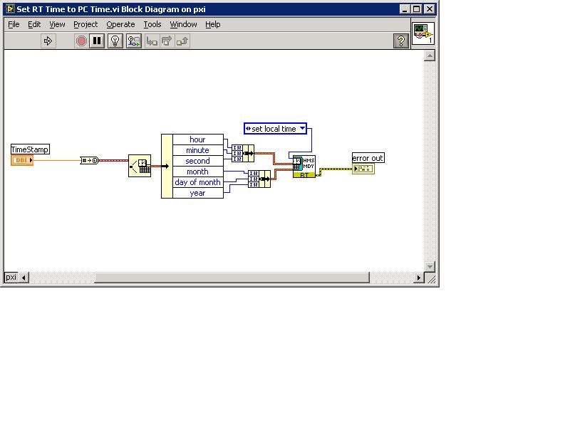

I don't see anything wrong with the code you've shown.    I think there could be something going on in your Set PC Time to RT Time VI.  Could you post this as well?  What version of LabVIEW are you using?

Chuck,
If you were to change your shared variable type to a "Time Stamp" data type and avoid the DBL conversion, would you see the same behaviour?  Nothing stands out at me with the code you have at present and the conversion really should not affect these results.  If the timestamp change does not affect your results, add the project to this discussion post and I'll try to reproduce the issue on my end.
