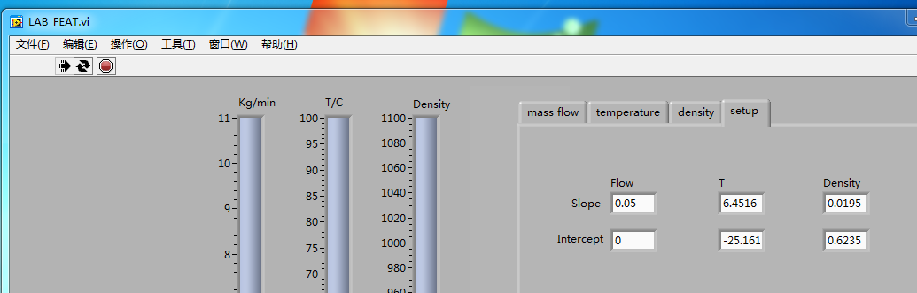

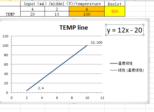

but  the linear function analytic, y=ax + b.
it says one 4~20mA means 4~100℃ temperature , one 4~20mA means 700~1100kg/l density.
4≈6.4516*4-25,161 ,100≈6.4516*20-25.161
There nothing show about ohm, besides current signal 4~20mA tramsfor to physical value 4~100℃ ,that's my question
If the vi scaling voltage to temperature value ,the line should be like this

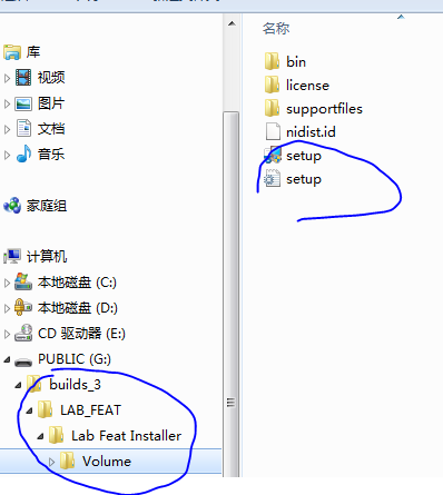

sorry, this builds can't be used for application?
but I only got this. what is needed if the application equipmets go to running? can you give some more details?

You don't have a VI or at least after reading it sounds like you just have an installer, no source so there isn't really anything we can give you advice about other than to work with who ever has the source code.

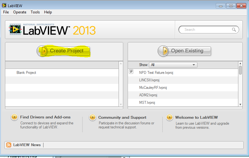

Next install LabVIEW and NI Device drivers.  An evaluation version would work fine Monday is much closer than 45 days away!
Launch the LabVIEW Development enviornment and you'll see the Getting Started Window:
Select Create Project:

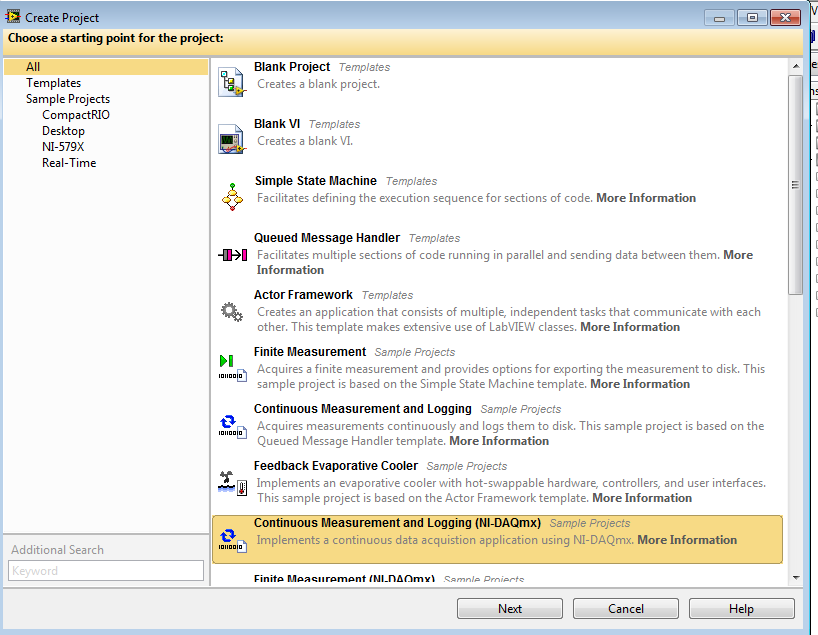

Select Continuous Measurement and Logging (NI-DAQmx)
See that Bold "More Information"  Click it so you will learn the concepts your coworker did not understand.
Add your DAQmx Tasks and Scales to the new project
Use the bookmark manager (Menu View>>Bookmark Manager) to find the bookmarks in the project read the comments and follow those instructions.
