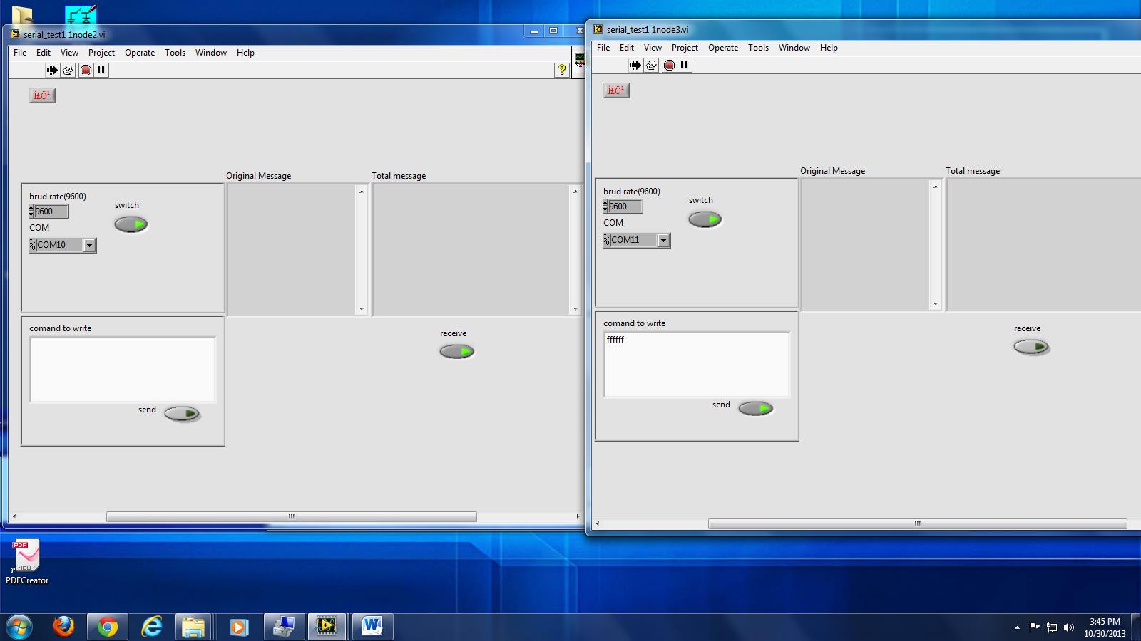

there is no error occur when i use visa function. I plan to use two wireless serial port to commuicate. One is on microcontroller one is on laptop. For the testing whether they could work. I use two wireless ports to plug into USB on the laptop.  One port is to write the string another is to read the string. The instrument is called "Silicon Labs CP210x USB to UART Bridge" in the hardware manager.
This is my program running like this:

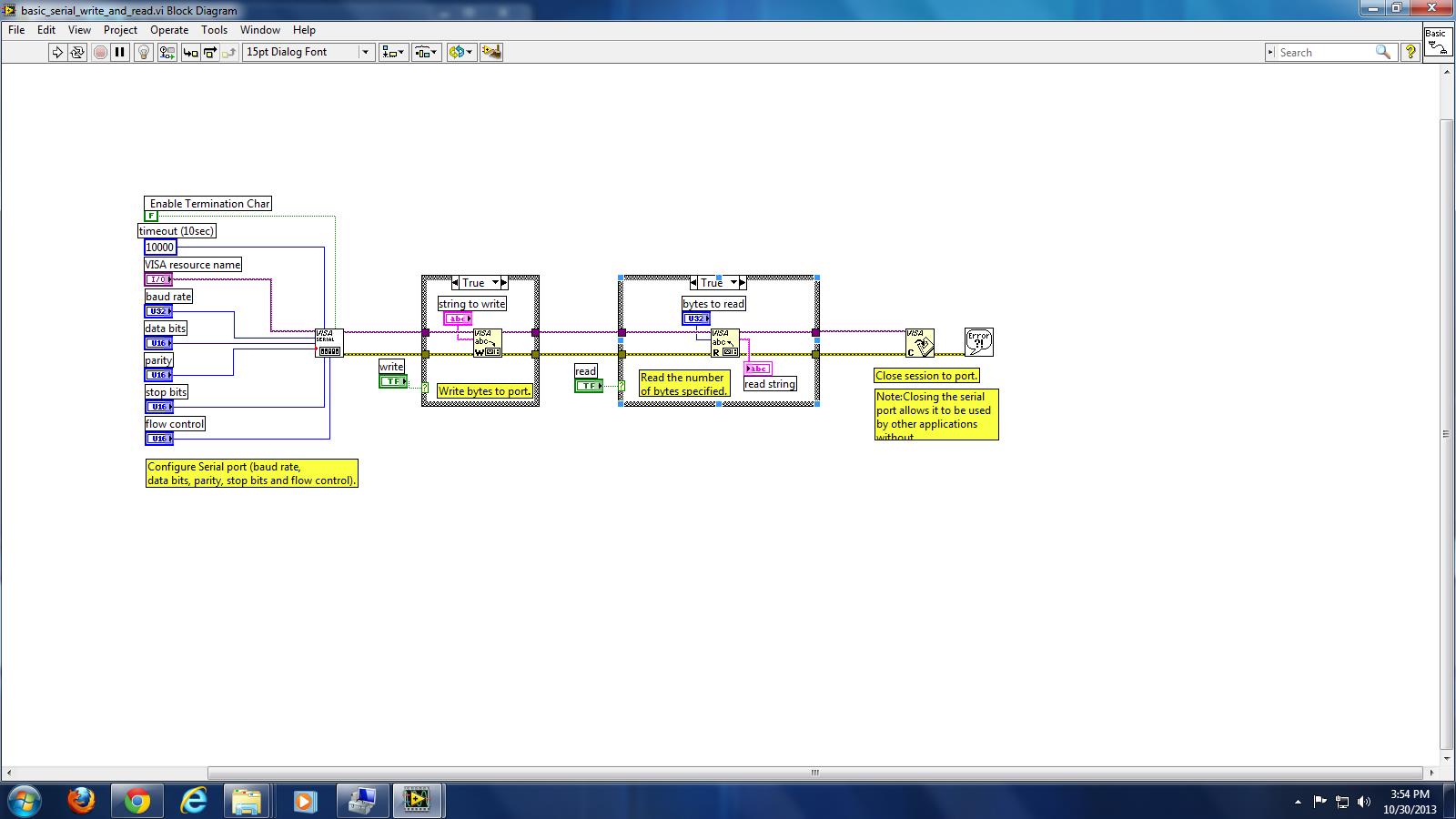

also I try the basic VISA read/write examples to test. But it is still not work and report error. This is example runing basic visa read/write:

Hi
  I am not familar with the event structure could you tell me more details?  I just wrote the program quite same as the example in the labview. which is basic visa write/read .
the example provided from the labview is like this
Here is the my  vi .could you help me to check that?

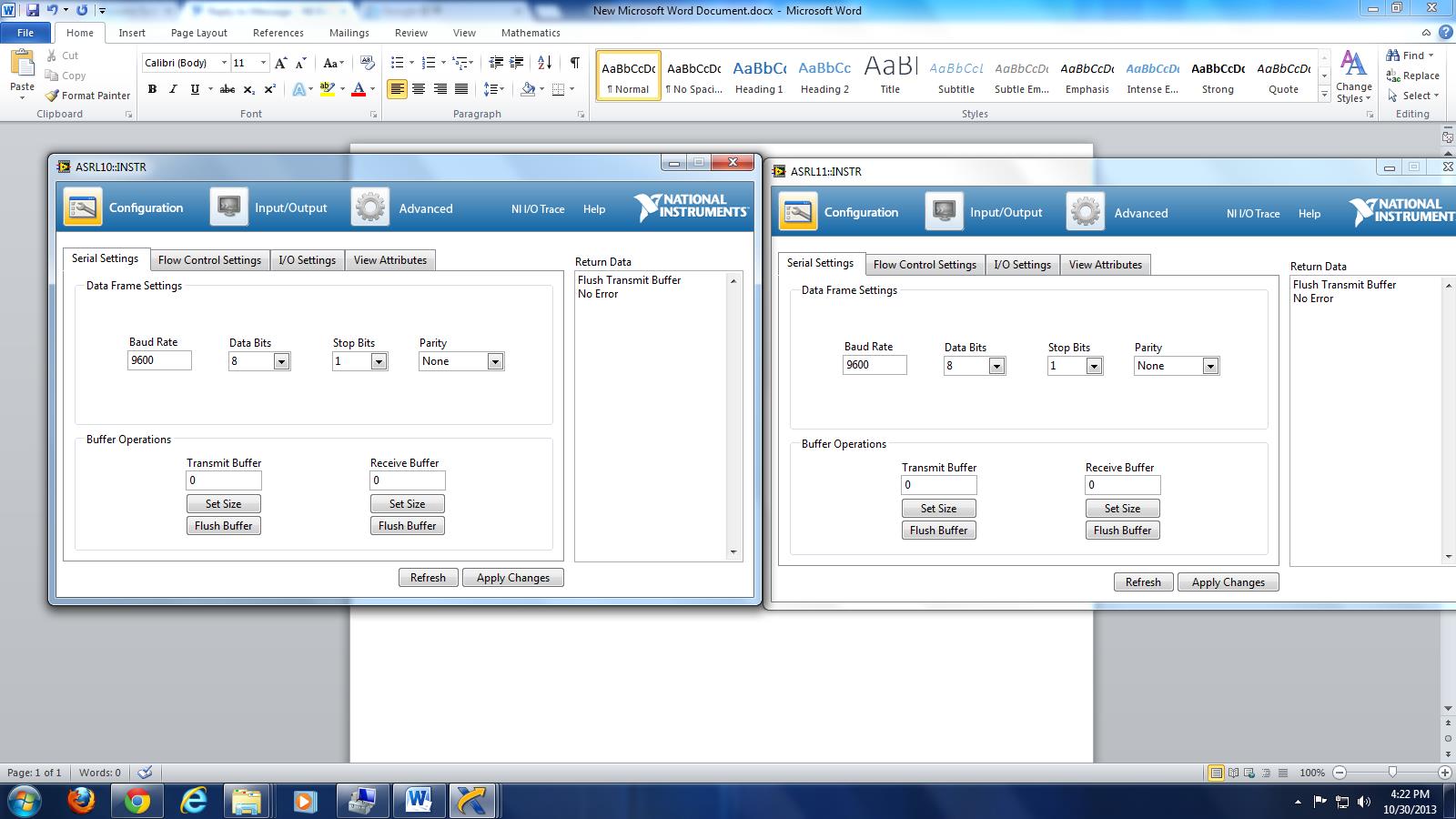

NI MAX has an integrated tool for testing serial communication- right-click on one of the COM ports you're trying to use and select "Open VISA Test Panel".

In your screenshot of the block diagram, there is nothing there that will show whether you have an error.  Put some probes on the error wire, or put indicators.  Now you might have an error, but it just gets passed all the way to the tunnel, and there is nothing there to show it.
In your second screenshot of the last post, you do have an error.  A timeout error, which means you didn't get a response back in time.
As for testing in MAX, it will give you more direct access to the VISA driver without have the layer of LabVIEW code in between.  If you go to the serial port shown in MAX, you can try reading and writing to the serial port from there.

 I have found that Open VISA Test Panel so how do we use that? or where we could check it is working right now.

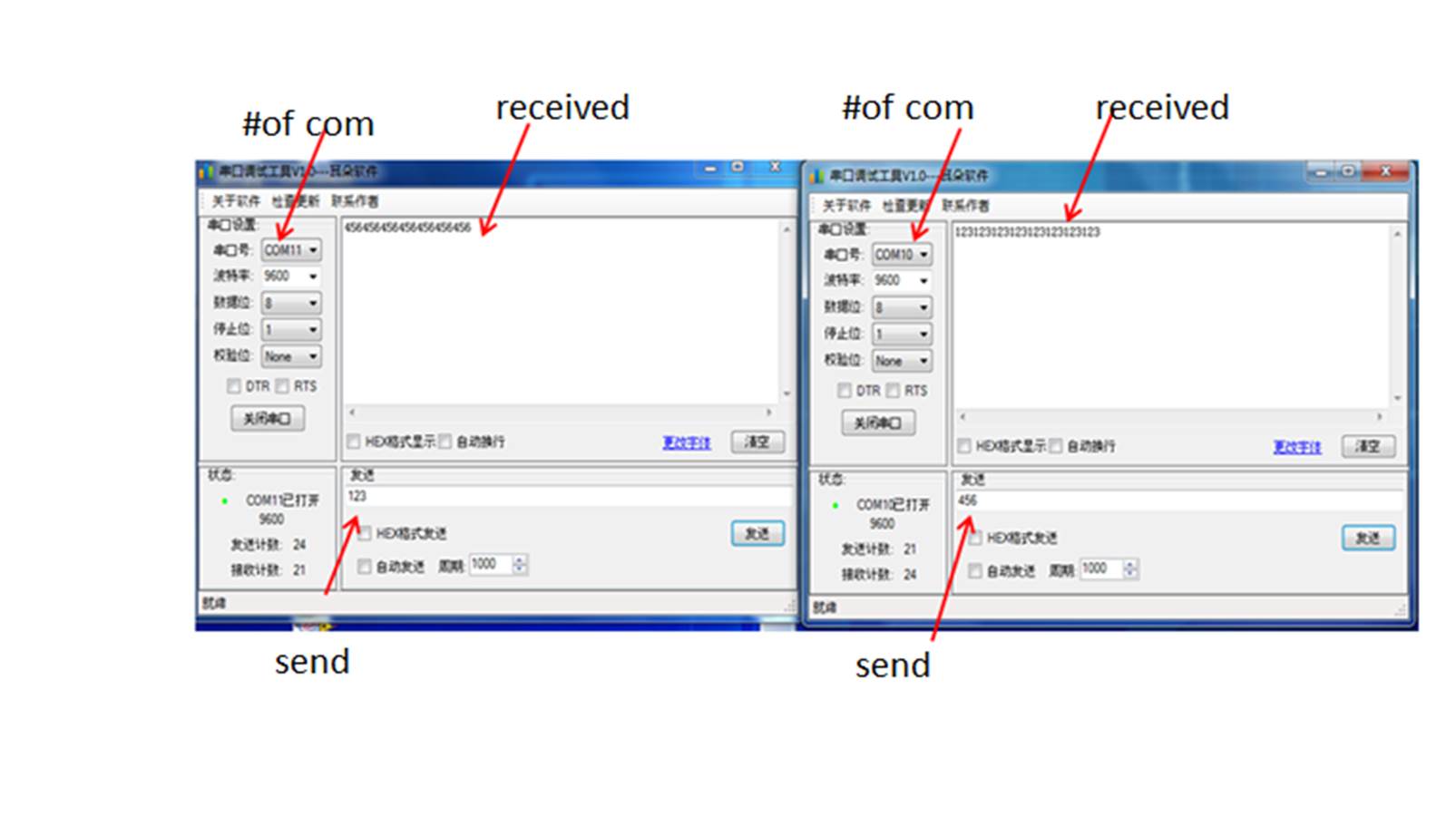

For the question you asked. you are right that I attempt to send data via one of these devices and read it on the other. I think they are paired in some way cause I just set the baud rate data bits and stop bits. and they will have communcation between each other. There is a small software called ComTool. I could make two serial ports to communicate correctly. therefore I didn't think that it will be hardware problem.
