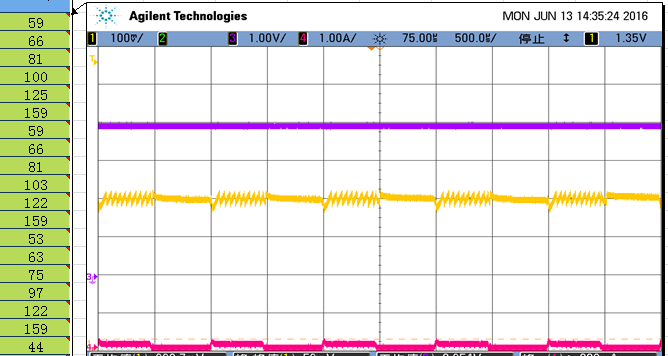

puting the mouse on the cellputing the mouse on the celldo not put the mouse on the celldo not put the mouse on the cell
I want to insert the pictuers in  officce excel  as the comments as shown above. When puting the mouse on the cell, meanwhile,showing the picture. But it seems that there is no available vi to achieve it in the report generation toolkit.  Could you give me some advice? I will appreciate it  very much if you could help me.

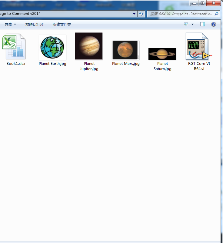

You need to insert the pictures as comment for the selected cells. I remember doing this a while ago, here is a version I modified to be used with the RGT (save in LV2014). Unzip the file and run the vi from the folder containing the pictures and the Excel workbook.

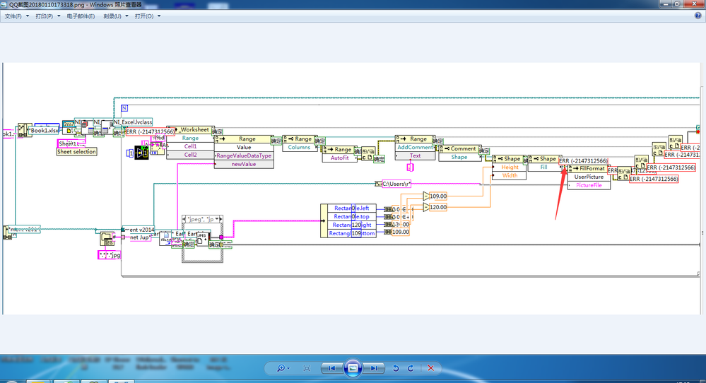

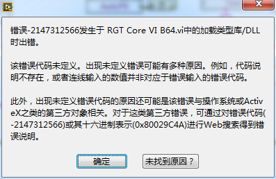

Excuse me,I asked you a question about inserting comments in excel on 22th Novembor,you gave me a example. Today, I opened it and found it making mistake when it runs to the arrow. Do you know what is wrong with it, thank you for your advice.
