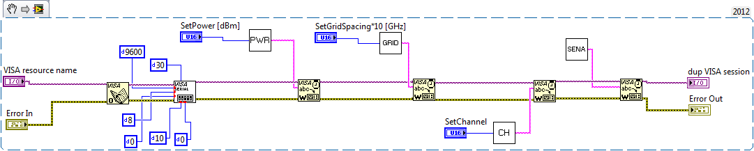

Hello, this is what all I have done.
I want to sweep the laser frequency. attached is the laser manual.

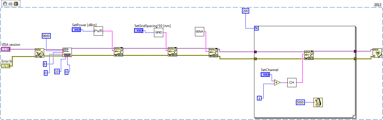

Sweep frequency:
but it didn't work, so I tried to just select a single channel:

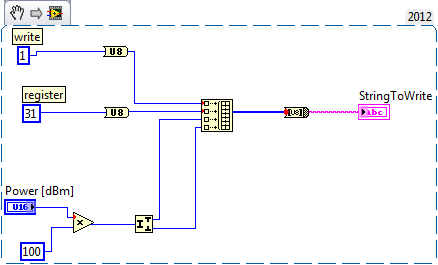

SetPower:

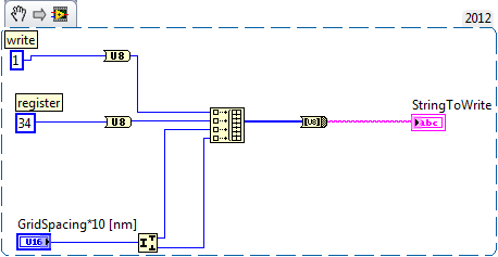

Set grid spacing between every two channels:

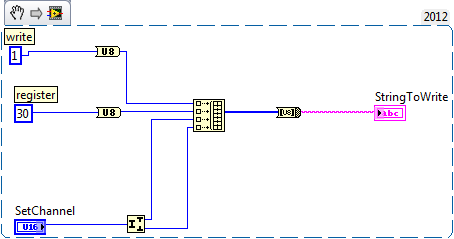

select channel:

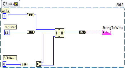

Enable optical output:
the problem is there is no wavelength output.........I want to sweep the frequency of different channels, but it didn't work, so I try to select a single channel, it didn't work, either.......maybe the initialize is wrong, or maybe the string I write is wrong?  I think before sweeping, there should be wavelength output at least....

Your string is wrong and I've said that several times. You are not following the protocol in the manual. Read it. Nothing will happen until you send the correct command.
