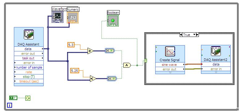

I have an external (real-physical) push button, which works like latch until released buttons... I watch with a Daq-assistant,if it's pressed or not (the Voltage will changed...) . I wan't to begin to send a signal, if i pushd the button, and i want to stop it, when i pushd it once more... But i have no idea how to do it... my program now send signal until my button is released ...

Yes, i wan't a switch when pressd button-action...But i don't want any LabView-button in my program... I wan't to make it with my own phisycal button... I have a  battery, and my button...when i push the button, my daq-assistant sense that, the Voltage changed from 0V to 5.28V. When i release my button, the Voltage will be 0V again...
My project now send a signal, if the Voltage is 5.28V.
But i wan't different. I wan't to send the signal after i pressd until i didn't pressd it once more...
Here is a picture from my program: forumra.JPG

It is hard to debug a screenshot.  What is going on in the right hand DAQ assistant?  What is the output it is doing?
Forget the output for a minute, does the boolean indicator on your front panel behave the way you want it to?
Your physical push button, is it a momentary type of push button, or is it a maintained contact?
By the way, you should create a stop button for your program instead of using a true constant on the loop's continue terminal.  Right now the only way to end the program is to abort it.

In the right hand daq assistant now i send a sinus signal to my daq, and in my daq there is a megaphone, so it make a bip-noise... But there can be a led too or anything else...
The indicator now light, when i push the button, and hold it. When i release it, it's blow out...
My physival push button is a maintained contact. Until i hold it, there will be a contact. When i released it, there will be no contatc.

Okay, so you have a momentary contact push button.  The first time you press it, you want your boolean to go from False to True.  The next time you press it, you want it to go from True to False.
You will need two shift registers, one to hold the value of the input from the last loop iteration so that it only acts on the False to True transition.  The implies function on the boolean palette helps with this.  The other that is your boolean of interest and it uses an XOR to toggle its value.
One thing you may have to worry about is debouncing the signal coming in from the switch.  A hardware switch may stutter on and off in fractions of a section when it is first pressed.  If this becomes a problem, you may need to set up a debounce filter in on your digital input circuit.
