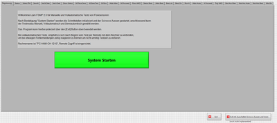

for controlling a (rather complicated) test System I created a GUI, based on Tabs, as I have many controls an indicators.
for occasional bugfixing I have additional Indicators, which I'd like to leave.
for the final application I'd like to limit the window only for a specific area.
I tried Splitters and decorations, but none of this worked..

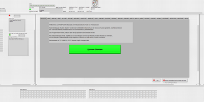

the whole front panel:
(currently with the splitters)
I'd like to reduce the Window, as soon as the System is running, limited to the center Splitter or anyhow to this Area:
what's the best way to achieve this?

Hi WWolf,
  1. I would get rid of all those splitters.
  2. Move the FP elements (select all, then move) so that the ROI is located at the FP origin with its upper left corner.
  3. Set the window size to show (only) your ROI.
  4. Hide scrollbars when executing (VI properties).
That should do the trick…
