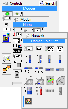

The simplest part of your question to answer is for color selection, just use the Color Box control.
