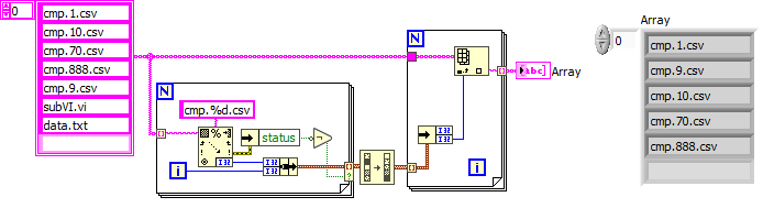

As you can see, the files will be sorted alphabetically, not numerically. As has been mentioned, it is typically advantageous to pad numbers in filenames with sufficient zeroes so alphabetic sorting = numeric sorting.  (alphabetically, 100 < 99, while 100 >099).
If you don't have control over the filenames, you can just sort the array of names according to your needs, e.g. as follows:
