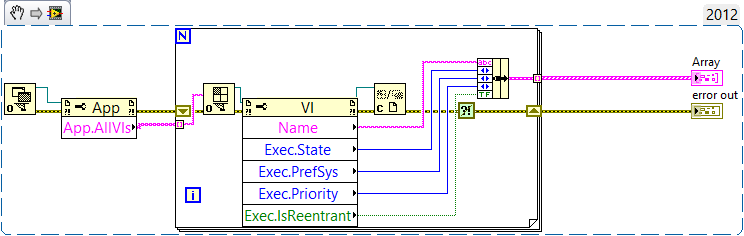

I did something similar recently while trying to optimize some code.  I was looking at the Execution settings, including Priority and whether or not the VI was reentrant, but the same idea would work for enumerating Front Panel properties.  Here's a snippet -- you can post-process the Array of Clusters to sort on the "column of interest" (and put a vertical scroll bar on the Array indicator, particularly if you have many VIs in your appliction).
Bob Schor
