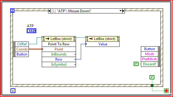

Rather than changing the value, you can do something like this - use the Mouse Down? event for the listbox. Because it's a filter event, it should execute first (although you might need to place it at an earlier frame in the event structure). Use the coords from that event and call the Point to Row Column method on the listbox. This will give you the row, which you can now keep in a shift register. Don't discard the event, and this will cause the menu event to occur, where you can now use the row value from before.

Thank you!
I had tried this originally with the difference being that I was trying to filter for button = 1 to see if I would get the right mouse button instead of the left.
I also had the filter state after the user runtime state.  I didn't know order made a difference.
Finally, to really improve the GUI feel, I had the returned ROW value write to the listbox VALUE of a property node in the filter state instead of writing it in the user runtime state.  This is because the highlighting of the row wasn't changing right away.
Now as soon as you right click, the highlighting reflects the current row, and then the parameter dialog pops up.
Awesome solution.  Thank you!
Charlie
(4,218 Views)
Here is the final..  just to be complete.  Smiley Wink
-=Charlie=-
(4,208 Views)
