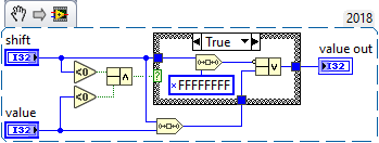

A logical shift is a "logical" shift meaning it does not account for any complement arithmetic use. That is also the reason why it is extremely cheap when translated to hardware logic. Two complements arithmetic is more complex and does require some extra logic to handle negative integer numbers (and is potentially even more complex for fixed point arithmetics).
There is potentially some way to make it less complex than a division but it won't be a single node. While for positive numbers it can remain a simple logical shift, for negative numbers however, either detected by the method as crossrulz showed or with a smaller than 0 node, it will involve two shifts and using a boolean OR operation.
Scale by Power of 2 as mentioned by Wiebe does basically this.

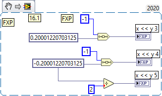

In integers, this logic is working.
But for FXP point shifting, we cant use boolean nodes.
Do we need to convert them to integers, then shift and again to FXP?
and
Does negate nodes consume more resources compared to the logical shift?
Message 9 of 12
(4,629 Views)
Yes you need to convert the FXP to an integer and back. And that does cost some resources for sure if the FXP is not 32 bit word length.
