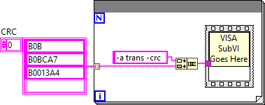

There is a lot of duplicated code. You should see if you can make a subvi that you can re-use multiple times.
What is the difference between the sub-vis and what stays the same?
Then you can use something like this and you dont need the channel index at all:

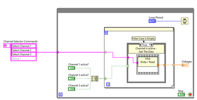

Your speed issues probably come from sending a lot of empty strings and waiting for the communication timeout. The solution would be to not send empty strings.
The code looks like you first enter the loop and then try to figure your way out by trying every exit. I think it is possible to know the route beforehand, like this:
This way, If a channel is not used, you are not writing to the line and waiting for a reply (that will not come).
