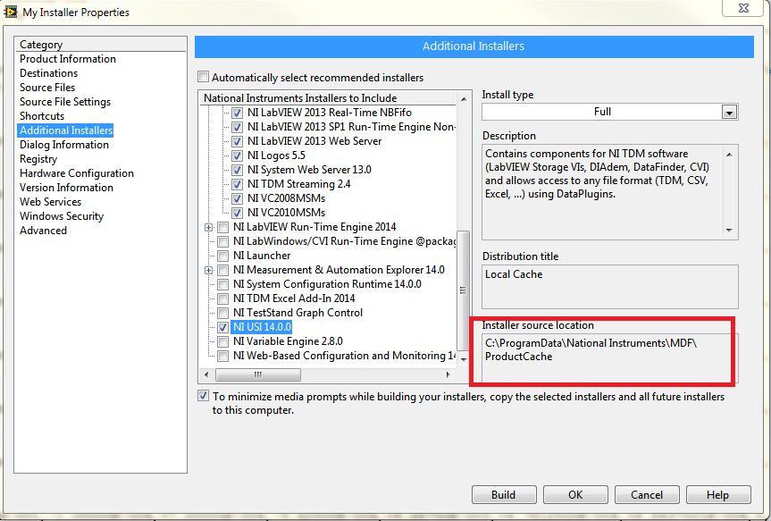

After log time. I have added NI USI to my LabVIEW installer even though it’s not working as I expected 😞
Munna
