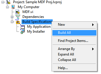

Since “lvStorage.dll” is missing in your computer, does the MDF.vi can be run without error alone?
If yes, please go ahead with the following steps.

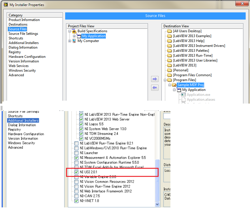

1. Create Application(EXE)
2. Create installer (please include NI USI manually as we discussed above)
3. Build All
If the installer is build successfully, please check whether the installer work in other PC.

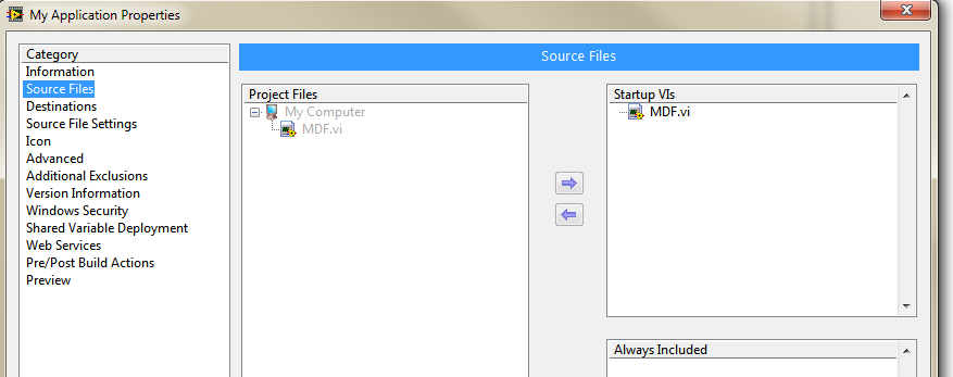

  1. I installed my Standalone application in other PC. I have not yet installed MDF Data Plugin. I think it will add in my project when we create Installer.
  2. In Project list just showing vi.lib in my dependencies list. It’s not showing “lvStorage.dll” but my VI is Running without any error.
