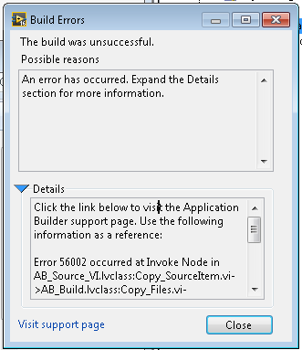

lvlibp build was unsuccesful : Error 56002 (solution and step-step to build a packed library)
I was building packed libraries in preparation of converting TestStand LabVIEW adapter to use LabVIEW RTE and ran into this problem many times, I hope this solution helps somebody!
Error 56002Error 56002
Problem:
Error 56002 occurs when building a packed library.
Solution:
The source library has 1 or more VI's that need to be opened and saved as being members of that library.
Steps to create a packed library:
1. Create a LabVIEW project, save it with a name. (preferably in same directory as source files)
2. Create a Library file in the project. Save it.
3. Add files to the Library file. Save library again.

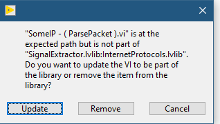

4. Open the Library file. Open each VI from the LIbrary. If prompted to update the VI to be part of the Library.... answer Update.
5. Save the Library file.
6. [in the Project] Create the Packed Library build specification.
7. Successfully build the packed library!

I replaced one vi in my project which was also part of the library. I needed to open the library and then from it open the vi I replaced. I was prompted to update the path and after this the build was successful.

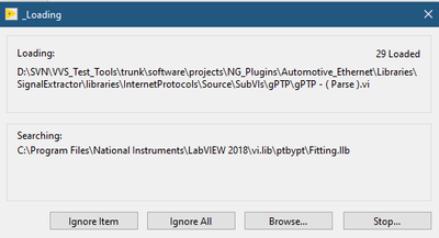

Same problem here, error 56002 should tell you the affected VI. A way to quickly identify the "bad" vi's for me was to drag all source libs into another one temporarily, which prompted the missing VI window
I noted all the VIs that it was looking for, luckily only 5 in my case. Then I moved the Lib back to its original place in the project and opened the affected VIs. This prompted this window for each one and I clicked "Update" for all
(3,743 Views)
