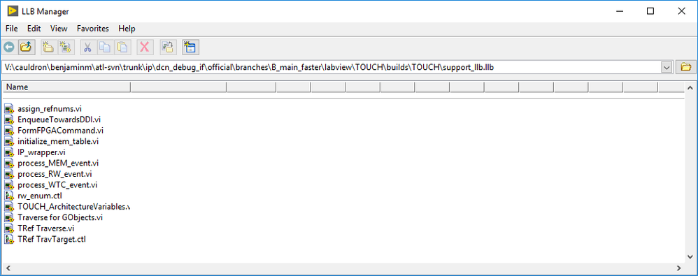

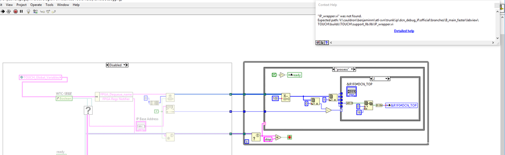

Here's some pictures that show my issue as I suspected...I hacked up some code so that I could remote debug.  Recall as stated in my previous post I built the llb, then I commented out the offending code to force it to load so I could see what's going on.  Notice the big question mark in the box on the left, and the error in the window when I hover over it.
image.pngBut here's the part I don't understand...it says it can't find it there, but the llb manager clearly shows it's there...notice the paths match and IP_wrapper is clearly there.  I'm perplexed....
