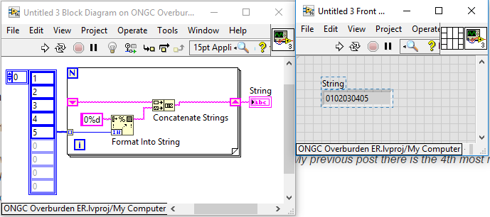

The easiest way to do this is to use precisely the same format (%02d) by passing your numbers into a "format into string" node.
Unfortunately these nodes don't handle arrays so you will have to run through a for loop if you want to iterate through the array.
Other options include the "number to decimal string" but that won't automatically prepend the zeros, the "number to hexadecimal string" will prepend zeros if you set the minimum width but unfortunately is in hex.
(4,215 Views)
Right, that's a good point. My solution will prepend ANY integer with a 0, %02d will only prepend 0-9 with a 0.
