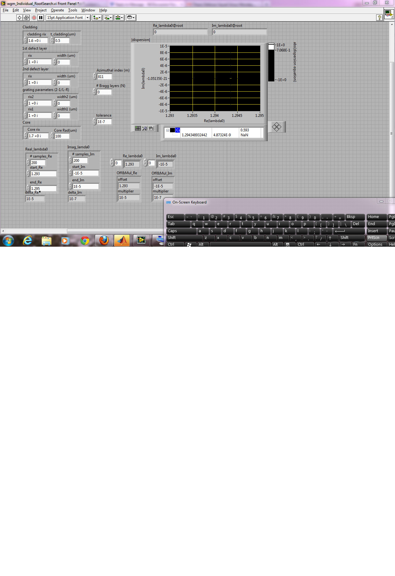

I am also getting error 1050. The script works fine in Matlab with the same parameters. But in Labview, the following error occurs :
Error 1050 occurred at LabVIEW:  Error occurred while executing script. Error message from server: ??? Error using ==> mtimes
Inner matrix dimensions must agree.
Error in ==> linspace at 22
y = [d1+(0:n-2)*(d2-d1)/(floor(n)-1) d2];
. in wgm_Individual_RootSearch.vi
The script is:-

Any hints will be really appreciated.. Where am I going wrong please let me know. Thanks  a lot.
The parameters are in the screenshot below:
Message 5 of 8
(8,302 Views)
Hi kikki,
As this is a very different issue then the first post, you would get more attention and better support from the community by creating your own thread.
Also, I cannot run your code because I am missing a lot of initialization values. They are probably in your screen shot but they don't match up to the names in the script so I can't tell for sure.
Sometimes MATLAB and LabVIEW interpret matrix differently (the rows and columns may be transposed). Therefore, my recommendation is that if you have matrix inputs to the MATLAB Script Node, you should try transposing the matrix before you send it to MATLAB.

Sorry Alisha, here's the code with all initialization values. Thanks for your response. I have passed vectors to similar Matlab scripts in the past and it worked. Have no idea what's going on here. //I can send you the vi by tomorrow if you need to look at it.

Hi Kikki,
Are you still having problems with this? (sorry, been on vacation)
I just tested your script in a MATLAB Script node in LabVIEW and it seemed to run just fine. That seems to indicate to me that the problem has to do with how the inputs/outputs to the node are set up.
Hope everything is going well!
