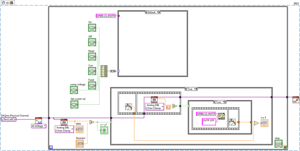

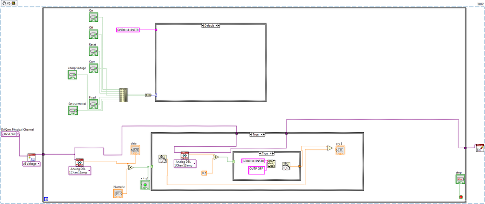

The snippet attached is what I came up with to enforce the order of execution I have in mind.
Thank you for your patience.

That's looking correct but very sloppy.  Try ctrl+U to clean up your diagram
Message 32 of 60
(2,053 Views)
Then I get the following image.
I really appreciate your help.
Of course once I am happy with the program and time characterization, I am going to remove the outer case structure and directly connect to the inner case structure (like the 2nd image below).

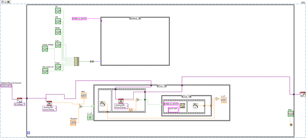

You also should wire the error chain and place an OR before the loop conditional terminal so the logic is
Continue unless Stop or Error  and wire the error out of the loop to a simple error handler to let you know when and what error occurs.
Message 34 of 60
(2,048 Views)
I think this is what you are recommending.  Sorry, I just started reading up on handling errors. I guess it's there to stop the while loop when the system runs into a glitch. Not sure what to do about "select error."

Also, don't split the DAQmx purple reference wire before the first read.  Connect the 2nd read to the 1st read's output at the top right of its connector panel.  It won't change the execution of your code, but follows standard practices of how LabVIEW block diagrams should look.

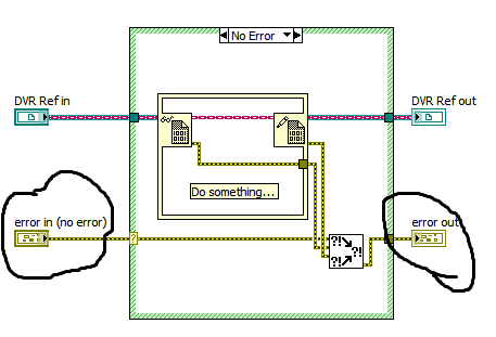

Thank you for your explanation.
For my experiment, I think I am pretty much done but for learning of how to use LabVIEW, I want to better understand error handling.
I looked everywhere and tried to create the error in and out I circled below (found the image online) but couldn't.  So, I just opened a few random examples and copied pasted it.  Could you tell me where I can find those units? (sorry, my lab computer just crashed so im using my personal laptop to post this question)

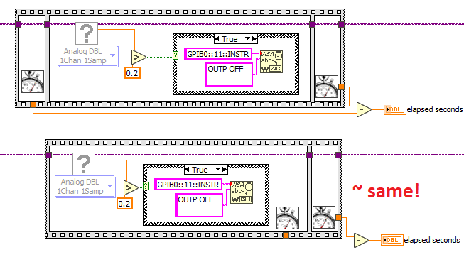

@nighthawk117 wrote:
Note that the innermost case structure belongs inside the innermost first sequence frame and should only contain the VISA call. Now you only need one instance of the ticker (i.e. nothing in the FALSE case). Avoid duplicate code! Avoid chopping up code into tiny fragments!
You only need one simple sequence structure, e.g. as follows:
(Sorry, I don't have DAQmx installed, so the AI read icon does not show)
You could even merge the first two sequence frames. It is unlikely that it makes a real difference here because the ticker is infinitely fast and the AI read is very slow in comparison. Within error, you'll get the same result if you start them in parallel.  Simpler code is easier to read, debug and maintain!
