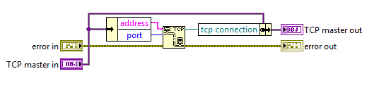

To answer your question...I am not sure. The modbus api on the master side acts as a pass-through to the open function. Here is the VI in question, but definitely let me know if you have any other questions.

Either way, my intent with that image was to show you that there is basically no magic happening on the master side of the connection. Anything you can do with the TCP primitive we can do with the modbus master. This is nice because you can simply connect to your device (on port 502) and that should tell you if you'll be able to connect using modbus. Can you clarify if this is sufficient, or what other info you need help with in order to troubleshoot effectively?
