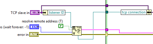

Okay.  Now I can see what you are talking about.
It appears that in the NI Slave Daemon, it uses the TCP Wait on Listener, and it has nothing wired into the Resolve Remote Address, so it defaults to True.  Now I don't know what is happening inside of there, so it must be returning the address of the connection that has been made as a string value.  It is not clear whether it is returning a computer name or an IP address as a string.  (perhaps you can experiment and put an indicator on that wire and see what it returns.)  But the that wire goes into MB Check Ethernet Client which ha MB Ethernet is Address Valid.  It seems to me that it is working with strings and looking for correct dot notation, I imagine as "xxx.xxx.xxx.xxx".  And comparisons are being made against global variables to see if the address is valid.
I can't see why the Wait on Listener would return a computer name.  If it knows the IP address (which is what TCP ultimately uses), I don't think it would do a reverse resolution to come up with a computer name.  It is possible to have several computer names all resolve to the same IP address, so which computer name would it choose if there were multiple choices?

I found this dialog helpful. In your original post you mentioned using the master VI, and I provided a screenshot of the only TCP functionality on the master (besides of course the read and write VIs)...but then you mentioned the slave daemon which is of course part of the slave API. This API uses a separate create listener/wait on listener pair in order to limit the number of connections to the system, but the code you seem to be most interested in looks like this:
As you can see that input is set to false because that information is useless for a slave daemon. I'm not really sure why true is the default, actually, but oh well.
