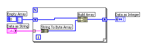

PGH,
To convert your data from a string back to a number, simply use the reverse of the same conversion method you used before (String to Byte Array.vi). Since your data is in an array of strings, you will need to use a for loop to index the array and convert each character one-by-one. Since the String to Byte Array.vi returns a number that is already within an array, you will need to insert it into a pre-existing array rather than index into an array (which would create a 2D array). I've posted a picture below about this concept.
Once you have an array of numeric data, you can simply connect it to the Write to Spreadsheet File.vi.
