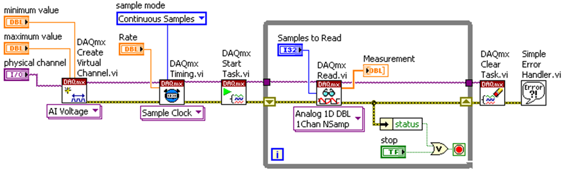

Does your code look something like this:
I wanted to explain a few points about this code first:
If you are using the Sample Clock on the Timing DAQmx VI you are effectively using hardware timing. This means that you are reliably reading 1000 samples into your DAQ buffer every second. The data from the buffer is then transferred to your PC buffer or in other words your RAM. The Samples to Read input of your DAQmx Read defines how many samples you read from your RAM into your graph which in this example is called Measurement. For example if you have set the rate at 1000 Hz and Samples to Read at 500 your loop will run every 0.5 seconds. If your Samples to Read is 100 your loop will run every 0.1 second. If your Samples to Read is 1000 your loop will run once every second. Because everything is hardware timed this is one of the instances where you don’t necessarily need timing in your loop. In order to regulate how many samples you are reading you just need to tweak your Samples to Read Value. I would suggest you keep changing this value and see how it affects the number of samples you've acquired.
