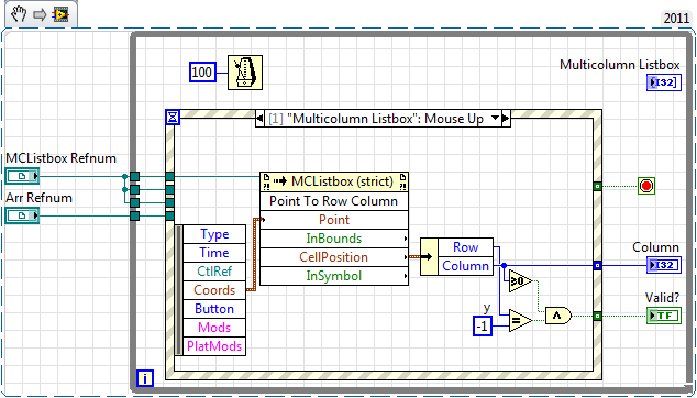

Assuming you only want to sort when clicking on the header, I would suggest that you call the MCLB's Point to Row Column method in the Mouse Up event and give it the click coords. Then, place the sorting code in a case structure and only execute it if row>=0.

I don't have LV in front of me, but you right click the control and select Create>>Invoke Node>>Point to Row Column. This will create an invoke node with the method. The method requires the point coordinates, which you can get from the Mouse Up event - one of the terminals on the left side should have that. The method then returns the row at that point, so you know if you clicked on the header.
As for the second question, I don't know if you should, but if you're asking if you can, then the answer is no. At least officially, LV does not have a MCLB with glyphs. What you can do is add the text /\ or V to the column's name using the Column Headers[] property.

What you are doing is correct but you also need to make sure that the row number is -1 as well to make sure its a header thats being clicked and not one of the cells.
CLA CTAChampionI'm attending the GLA Summit!

try this
