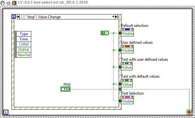

Thanks steve,
                       I've started modifying the code using event structures.here I'm having one problem.If I press the stop button,the program doesn't stop.Please see the attached code
Regards
RobinHood
Message 24 of 25
(1,193 Views)
You should add an event case for a value change event of the stop-button:
