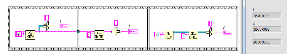

- My first Idea was to remove all queue wires and connect to queue by its name like in frame 3:
But Desktop trace execution Toolkit shows that I have memory leak. Documentation says that new queue ref is created when I obtain queue that exists and adresses shows that is true.

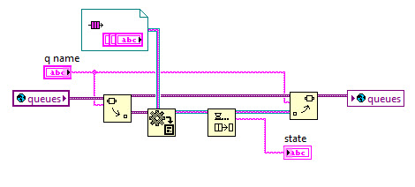

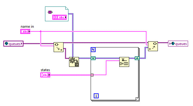

-My secound Idea was to use variant atribute and global variable and create functions that will allow me to create, exit , enq and dequeue from whom and whenever I want. Schematic idea looks like this
create
enq
deq
exit
This time I didn't have leaks so may I assume this is correct way?

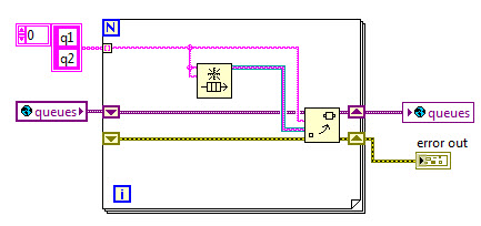

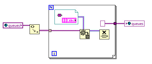

-My third idea was to bundle all queues into cluster and then bundle and unbundle by name whenever I want, There is openG function that allows me to get value from cluster by name so if I name queues it should be easy to do. So I will only have 1 wire for cluster and 1 wire for error for each loop. In this case data flow is keept because all stays with cluster.

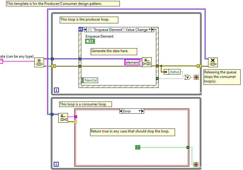

Look at the Master/slave pattern (file/new/templates/master...), that's basically how it should be done.
/Y

That sounds like the wrong exaple. 🙂 It should be an event driven producer and a queue-consumer.
Your example ofc has a memory leak since you dont release the queue.
/Y
