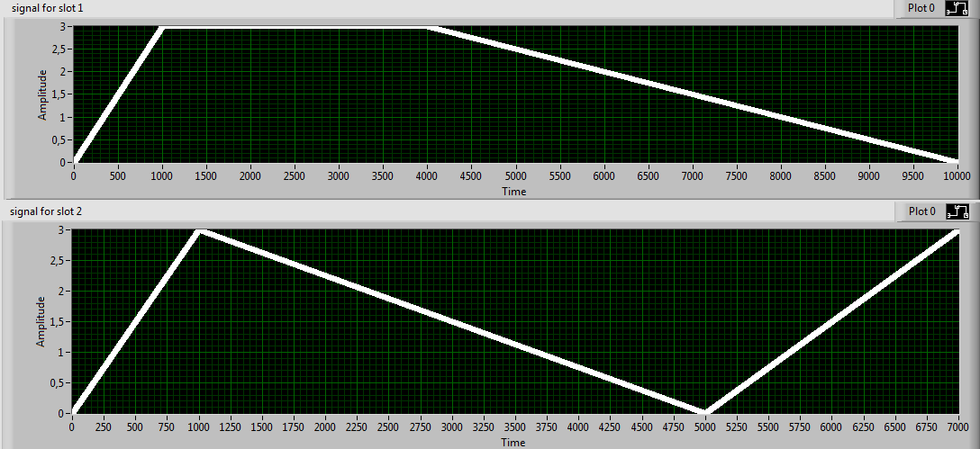

Here are my 2 signals, first one has 1kHz, secound has 1 Hz. I can say that maximum frequency for signals will be 1kHz,then logical step is to resample all signals to that frequency
And then I need to generate in continious mode without regeneration? I will need to move this large signals into buffer in smaller parts?

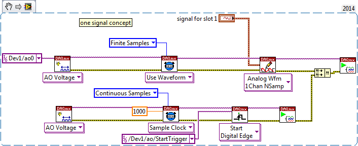

I attach example how this concept looks now with some questions
When using cDAQ I can run up to 3 concurrent AO tasks?
