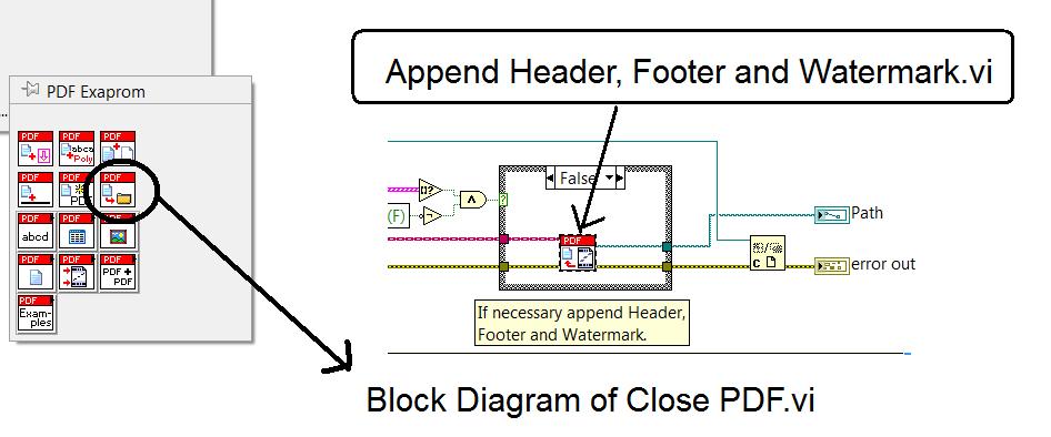

If you open "Close PDF.vi", you will find a vi named "Append Header, Footer and Watermark.vi".

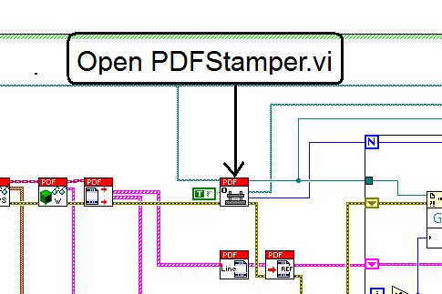

Open "Append Header, Footer and Watermark.vi".  On the block diagram you will find a vi named "Open PDFStamper.vi"
Open "Open PDFStamper.vi"

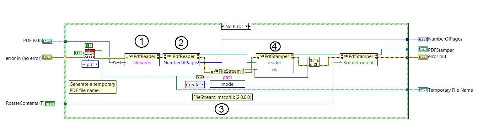

1) You have here your "PdfReader";
2) If the PDF document has more than 1 page, you need this information;
3) You create a file stream for the PdfStamper;
4) you create the PdfStamper.
You have to understand that you not overwrite the original PDF file.  The PdfStamper will copy page by page the original PDF file in a new file and you will overwrite, page by page, this new PDF file.
After you finish, don't forget to close your PdfReader and PdfStamper and the corresponding references.

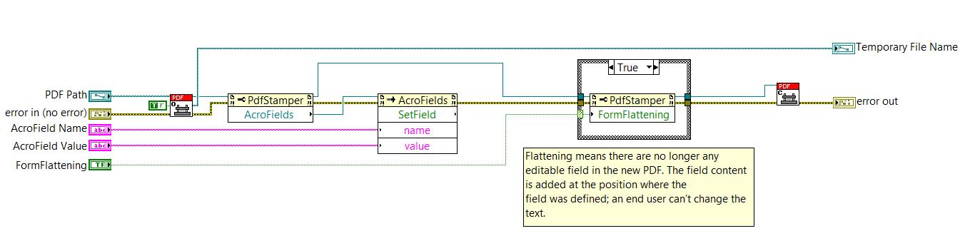

I don't have the time to dig, but what you want should look like this (I don't test this vi):
You will have to relink Open PDF Stamper.vi and Close PDF Stamper.vi.
