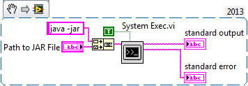

Dear Valarauca,
In order to better assist you, please elaborate more on what you are trying to accomplish and how do you want LabVIEW to work with this file.
Are you trying to launch an application, compile a Jar file and launch an application, or extract data from the jar file ?
I found some links that might be helpful for you :
http://digital.ni.com/public.nsf/allkb/BEE812007BA2A9B486256BC80068A49A?OpenDocument
https://forums.ni.com/t5/Example-Code/LabVIEW-Java-Compiler/ta-p/3533640
In addition I am including an alternate way of opening a jar file. This is a snippet of a simple VI using the system exec VI. This VI operates like opening something in the windows "Run". Try using this as an example and see if you get the same errors.
