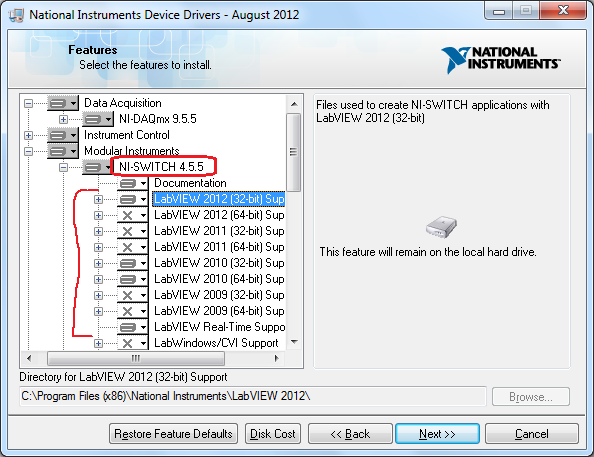

Why dont you install the NI driver support for switch/relay in other PC and then you will be able to access the same example un that PC/machine also.
As if you try to copy and bring the example code from other PC, you might not able to include all the dependencies (this includes subVIs, dll etc).

If LabVIEW is installed in a computer, it doesn't guarantee that subVIs and examples will also be present rather subVIs and examples (related to a specific NI device) will only be available if that particular driver (and corresponding LabVIEW support) is installed.
E.g. for Switch you need to install:
NI Switch Driver installation

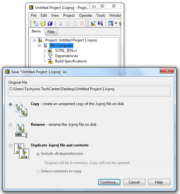

Follow the steps
1. Open your VI in a new LabVIEW project.
2. Save this project.
3. Now in the project explorer window select File >> Save as, and you'll see following dialog.
Open in Project
4. Now you can choose to 'Duplicate'.
