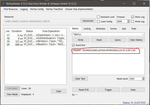

I also tested with NI MAX and R&S VISA software and the results are as follows.
(2,509 Views)
You don't mention how your are physically connected to the instrument?  GPIB, USB, LAN?
It could also be because you have multiple versions of VISA installed (NI VISA, Keysight VISA, R&S VISA, etc..) which seems likely if you have Agilent, R&S and LabVIEW installed.  Make sure you have the VISA setup as described in this reference.. https://knowledge.ni.com/KnowledgeArticleDetails?id=kA03q000000YHh0CAG&l=en-CA
