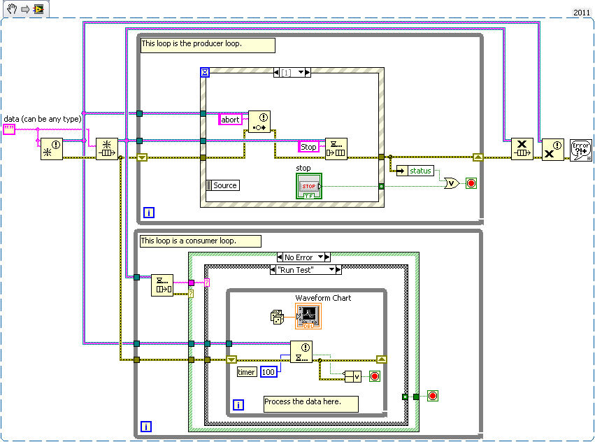

use abort "notifier" to stop lower level processes(loop) and to time the process...

Many thanks guys - I have a nice solution now (attached), using the timout function on the get notifier.
Jon.

looking at your vi...it is not properly shutting down, why your vi is doing what you want is because you are inducing an error to the bottom loop by not handling the user stop interface.
btw, my vi should have had the error tunnels merged outside the loops and the input error on the "dequeue element" connected.MY BAD!

Hi Apok,
No, look at my vi again. By pressing Test you can turn the generation on and off. The Stop condition is also handled fine I think - it's OK to use an error, as long as it's handled properly.
Thanks for taking the time though - apprecated.
