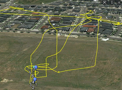

I want to do something like this. Can you help me with this
Sounds like a fun project, Have you written any code yet?

I tried using a static map image and plotting it on the XY graph but that's not the exact way I wanted. As I want the lat and long to be plotted on the map
