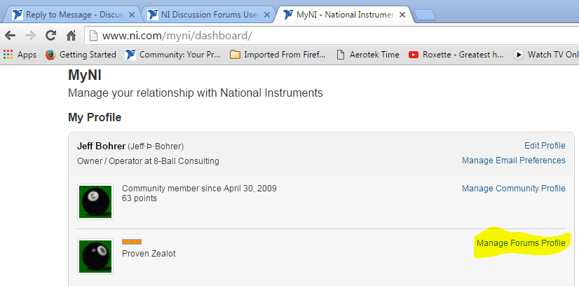

SIDE NOTE: Go to MyNI and Select "Manage Forum Profile"
Change your forum alias to anything other than an E-Mail address!  This is a public forum and the ocassional spammer will harvest e-mail addresses.
