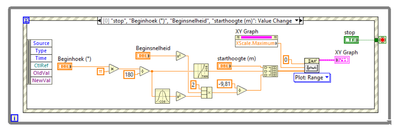

here is my block diagram
No, that's just a picture! If you want more people to look at your VI, use "save for previous (2020 or below)" before attaching. Many don't have LabVIEW 2024.

See if this can give you some ideas...
A few points:
  • Do not start duplicate threads for the same problem
  • Do not maximize the front panel and diagram. That's annoying.
  • Use a scale range change event, not mouse-up event for the graph
  • Use a timeout to update the output based on the current settings when the VI starts.
  • etc.
